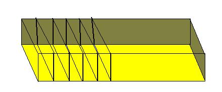

Ive seen here and there on various builders websites creative ways to store selected sets of wood, wood that a client has picked and you pull it and set it aside. Id like to make a rack for this purpose. I'm wondering, is it smart to put the wood on edge? I'm thinking book-shelve style, with wooden dowel separators for each bay. That way, I could slide in the top, backs and sides and maybe even a selected fretboard blank, etc.
Id like it to hang from the ceiling, so its up and out of the way.
Here is a quick and dirty drawing. I guess my question is basically, is it safe to store wood like this? On Edge that is.
Thoughts?
Thx

Lance,
It's always a good idea to separate a client's wood and I think you've hit on a great idea. My only suggestion is to try and keep the wood as flat as possible regardless of how the wood is stored. You shouldn't have any trouble with keeping the wood on its side so long as you have a tight fit.
just my 2 cents.

Or, you could buy a cheapie cabinet, and install a bunch of flat 1/4" shelving units about every 1.5" apart and then just stack up the wood inside. Top first, then back, then sides, figerboard, bridge, headplate etc.
If you didn't secure the shelves and simply let them set on dado cuts you could slide the shelves in and out when you wanted access.
I know this doesn't put it on the ceiling like you wanted, but it would let you store the wood as joined up and thinned plates as well.
Just another approach.

I have stored some wood on edge as you were thinking Lance. It doesn't seem to have any ill effect, but flat is probably better. I have seen some guys do the cabinet thing and that seems to work great.

Consider small (perhaps 8"w x 24"h x 24"d) storage bays, that you can store all the parts for the guitar before, and during the construction phase. It's a way to make sure you have everything you need when the time comes to start the instrument.
As far as storing plates go, a good system is the one that Martin (and others) use. Pegboard above and below, with 1/4" wooden dowels as spacers every 1". Rough plates, braced plates, etc can be neatly organized on their sides.
If the wood has been stickered/stored/acclimated to your space, there shouldn't be any need to keep it tightly constrained. In fact I would say it's counter-productive. If it's going to misbehave (ie. cup/twist), let it do so early on, instead of as you start the building process. It's never been an issue over several years and many dozens of instruments.
In other words, you should have a system for seasoning wood and ensuring proper moisture content and stability. Move to the storage rack only after the wood is acclimated.
